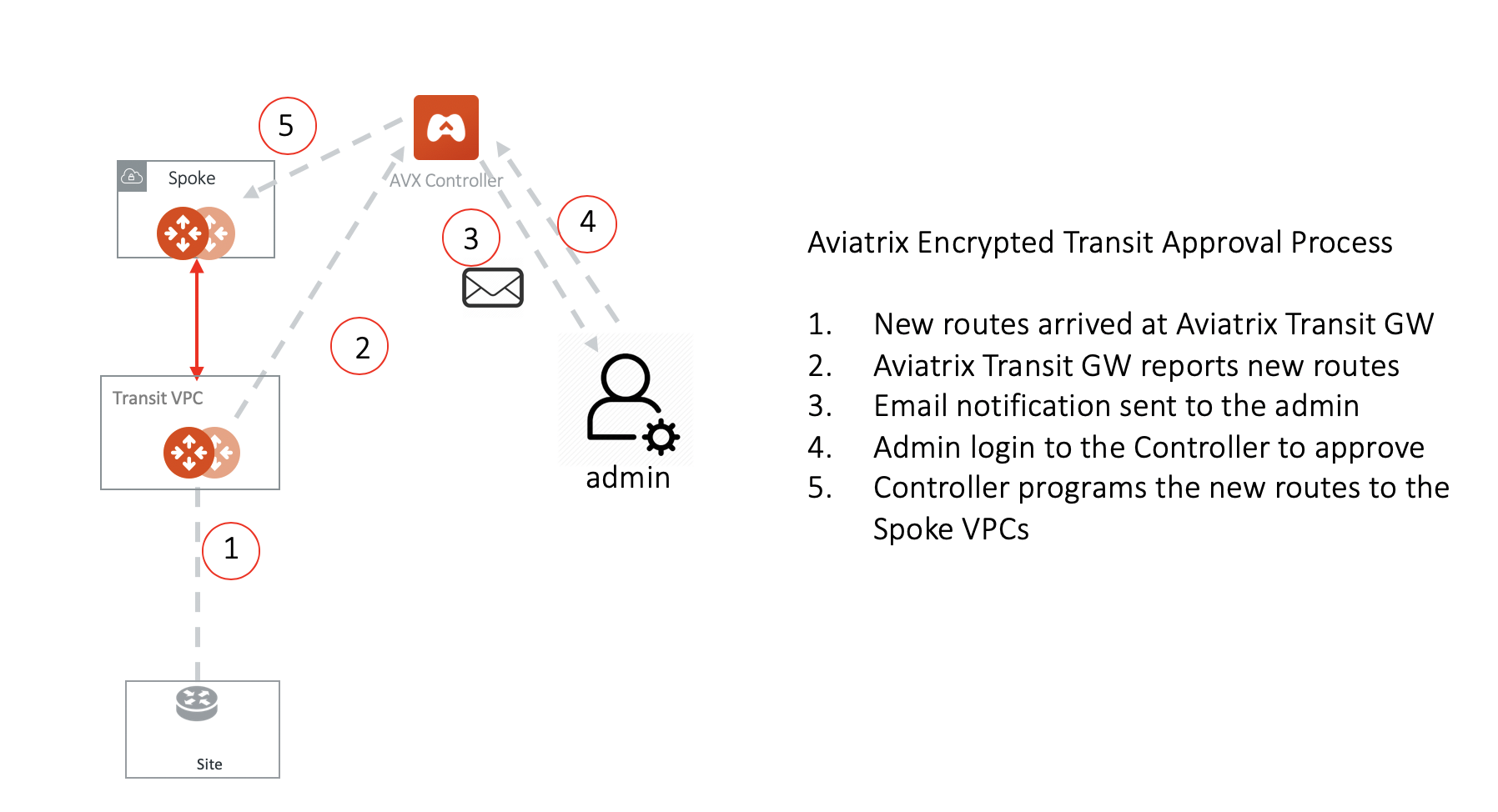

Transit Approval
The Learned CIDR Approval feature enforces this process. When enabled, dynamically learned routes from all remote peers trigger an email notification to the Controller administrator. To propagate the learned routes to the Spoke VPC or VNet route table, the Controller administrator should log in to the CoPilot and approve the learned routes.

When Gateway Learned CIDR Approval is enabled, an email notification is sent to the Aviatrix Controller administrator to approve the learned CIDRs. On approval the learned CIDRs are propagated to the Spoke VPC or VNet route table.
