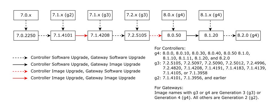

Major Upgrade Paths Overview
| Current Version | End Version | Upgrade Path 6 |
8.1.x 5 |
8.2.0 (Latest 8.2 Controller version) |
8.1.x → 8.1.20 → 8.2.0
8.0.x 4 |
8.0.x → 8.0.50 → 8.1.20 → 8.2.0
7.2.x 3 |
7.2.x → 7.2.5105 → 8.0.50 → 8.1.20 → 8.2.0
7.1.4105 |
7.1.4105 → 7.1.4208 → 7.2.5105 → 8.0.50 → 8.1.20 → 8.2.0
7.1.x 2 |
7.1.x → 7.1.4101 → 7.1.4208 → 7.2.5105 → 8.0.50 → 8.1.20 → 8.2.0
7.0.x 1 |
7.0.x → 7.0.2250 → 7.1.4101 → 7.1.4208 → 7.2.5105 → 8.0.50 → 8.1.20 → 8.2.0

Perform a software upgrade of your Controller and gateways to the latest release version within the current release. See Upgrade of your Controller and gateways within the current release.
Back up your Controller data. See Back up your Controller data.
Perform a Controller Image Upgrade Dry Run to check for potential errors.
Resolve any potential errors according to the provided solutions.
Perform an Image Upgrade of your Controller to the latest Aviatrix supported image. See Image Upgrade of your Controller to the Latest Aviatrix Supported Images.
If your Controller has been upgraded to 7.1.3958 or later, you can perform a software upgrade to 7.1.4208 (latest 7.1 version). Then perform software upgrade to 7.2.5105. If your Controller is already on 7.2.x, skip this step. Then perform a software upgrade to 7.2.5105 (latest 7.2 version). Then, perform an image upgrade from 7.2.5105 to 8.0.50. Then you can perform a software upgrade from 8.0.50 to 8.1.20. Then you can perform another software upgrade to 8.2.0 (latest 8.2 version).
Verify your Controller Upgrade Status.
Perform an Image Upgrade of all your gateways to the latest Aviatrix supported image. See Image Upgrade of your Gateways to the Latest Aviatrix Supported Images.
If your gateways have been upgraded to 7.1.3958 or later, you can perform a software upgrade to 7.1.4208 for the latest 7.1 software release. If your Controller is already on 7.2.x, skip this step. You can then perform another software upgrade to 7.2.5105 for the latest 7.2 software version. Then you can perform a software upgrade from 7.2.5105 to 8.0.50. Then, you can perform an image upgrade from 8.0.50 to 8.1.20. Then you can perform another software upgrade to 8.2.0 for the latest 8.2 software version. -
